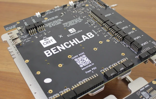

BENCHLAB is a cutting-edge, compact real-time system telemetry solution engineered for PC DIY enthusiasts. It allows you to effortlessly monitor critical system metrics, including temperature, power usage, and voltage levels, as well as conveniently manage system fan speeds. The telemetry data is displayed in the BENCHLAB software which also allows you to log the data to a file or export directly to HWiNFO.
BENCHLAB empowers you to make informed decisions when fine-tuning your system’s performance. It helps identify potential hardware issues before they escalate, and optimise your hardware configurations seamlessly. Its intuitive design makes it an indispensable tool for both seasoned overclockers or PC DIY enthusiasts, simplifying the complexities of PC DIY system monitoring.
Improvements in BENCHLAB 2
  • Improved noise and voltage drop across all rails thanks to 6-layer PCB design
  • Per-pin 12VHPWR/12V-2×6 monitoring for both connectors
  • 12VHPWR/12V-2×6 in/out temperature monitoring
  • Additional mounting holes for Corsair Frame 4000D/5000D chassis.
  • Support for mounting up to 2 SSDs
  • 5VSB switch function
  • Physical power on and reset buttons
  • Buzzer for audible warning
  • Integrated fault detection and alarm system for device protection
