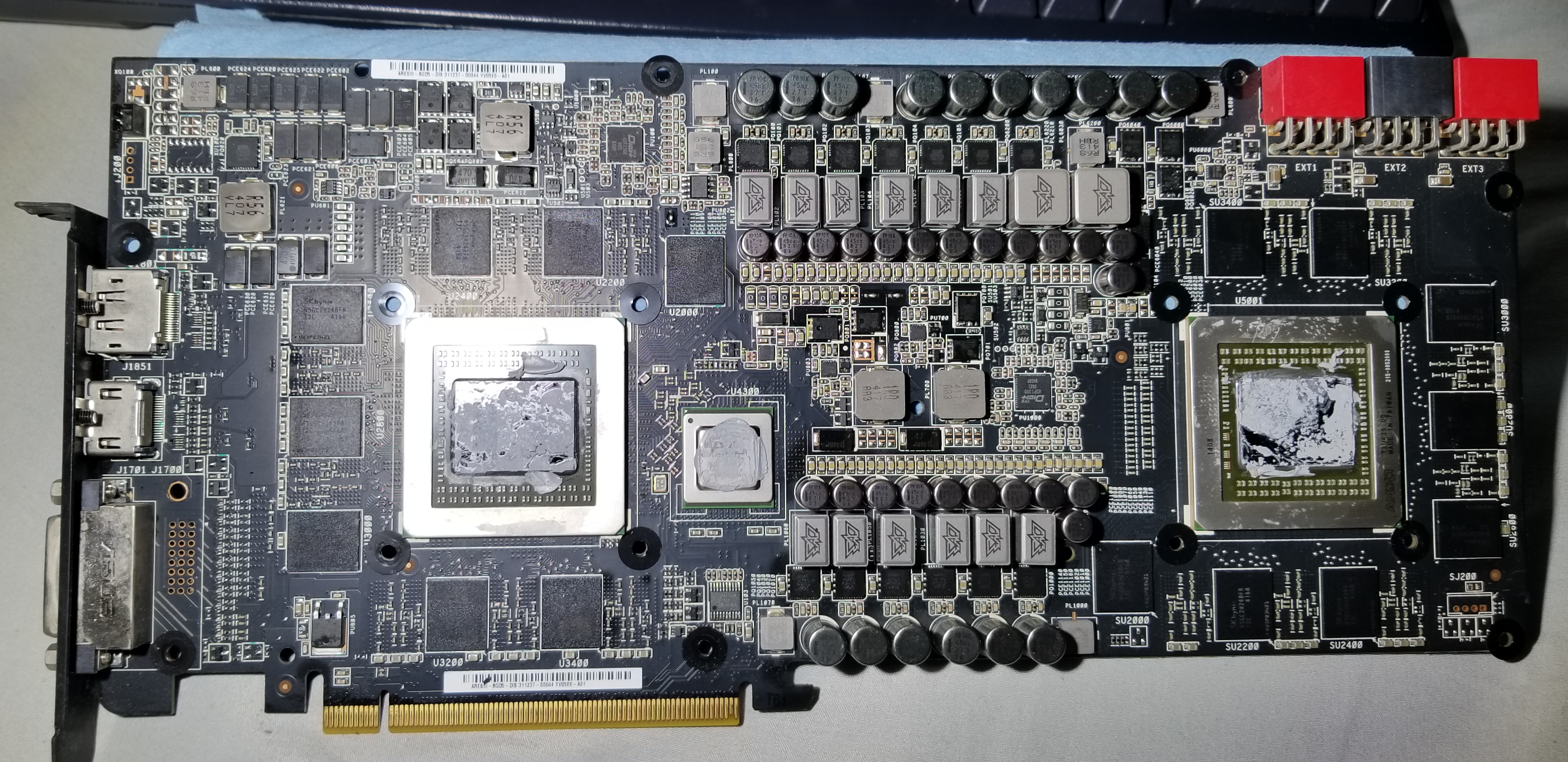

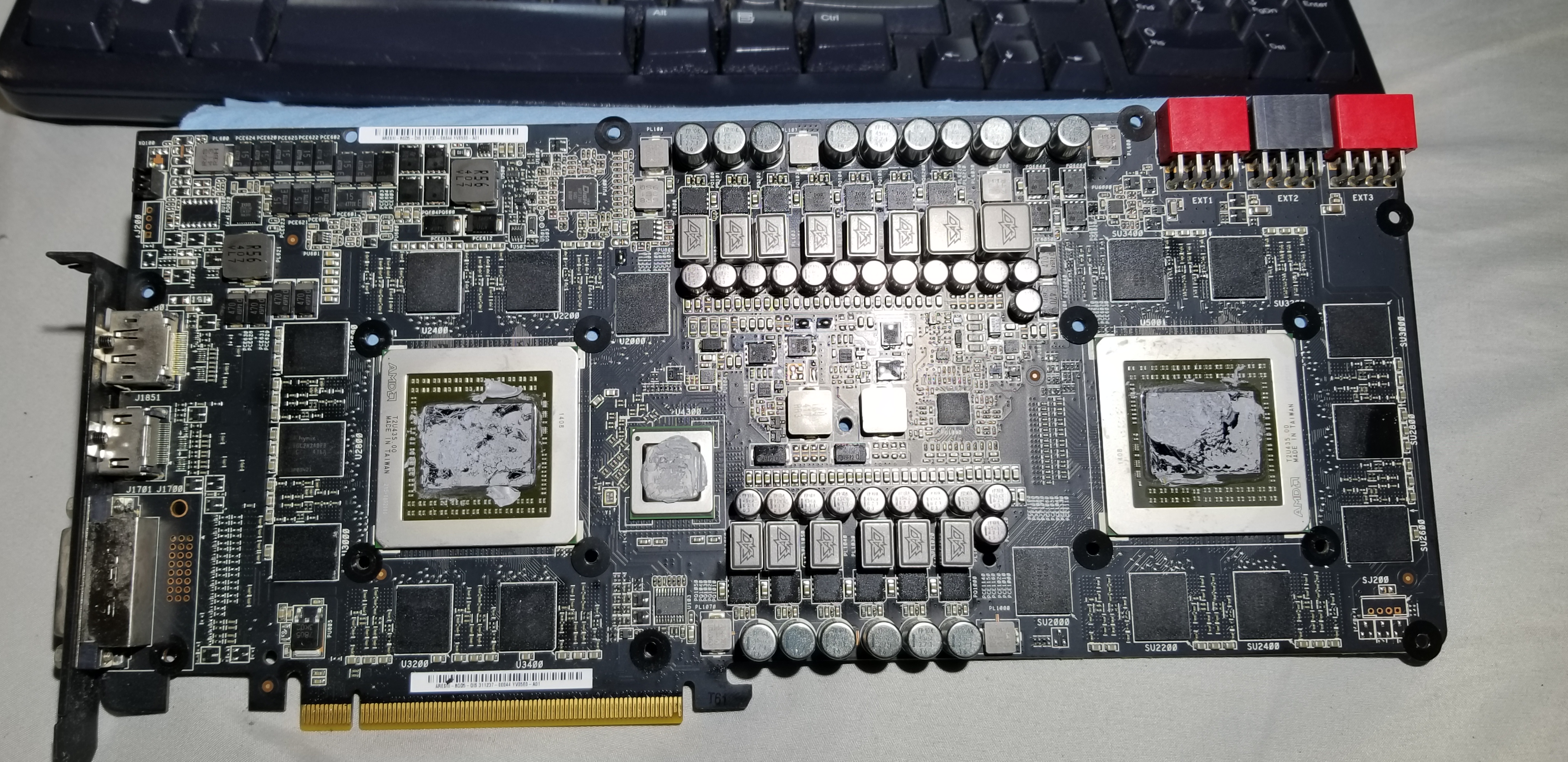

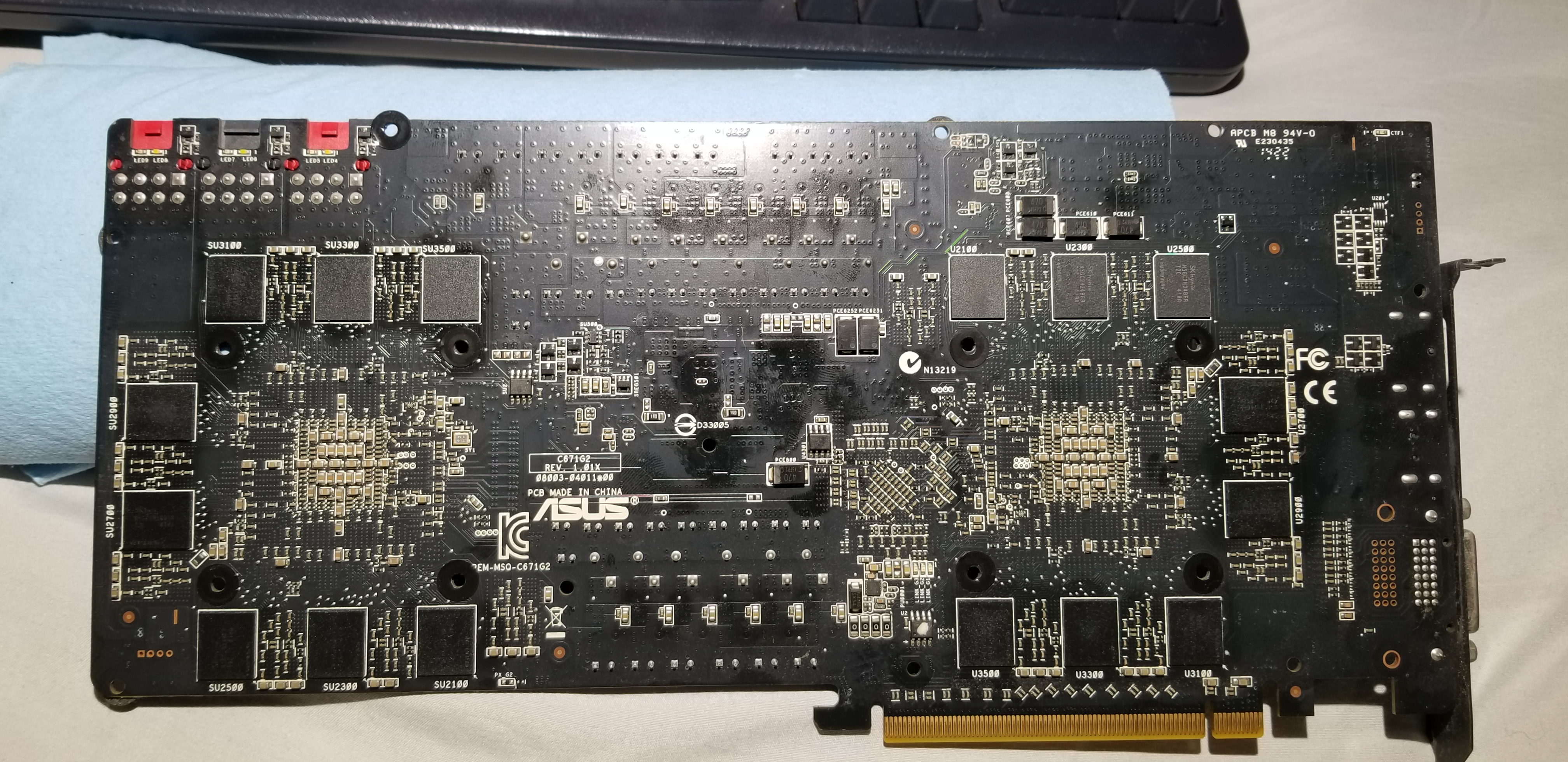

Quote from MsiMax on 2020-08-13, 02:56hi i bought a couple of evc2 to play with but im trying to find documentation im a noob in this area but i wanted to know if i can use on this card

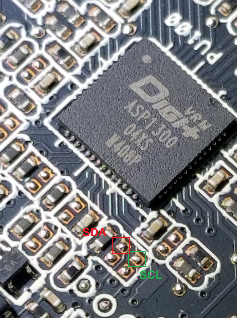

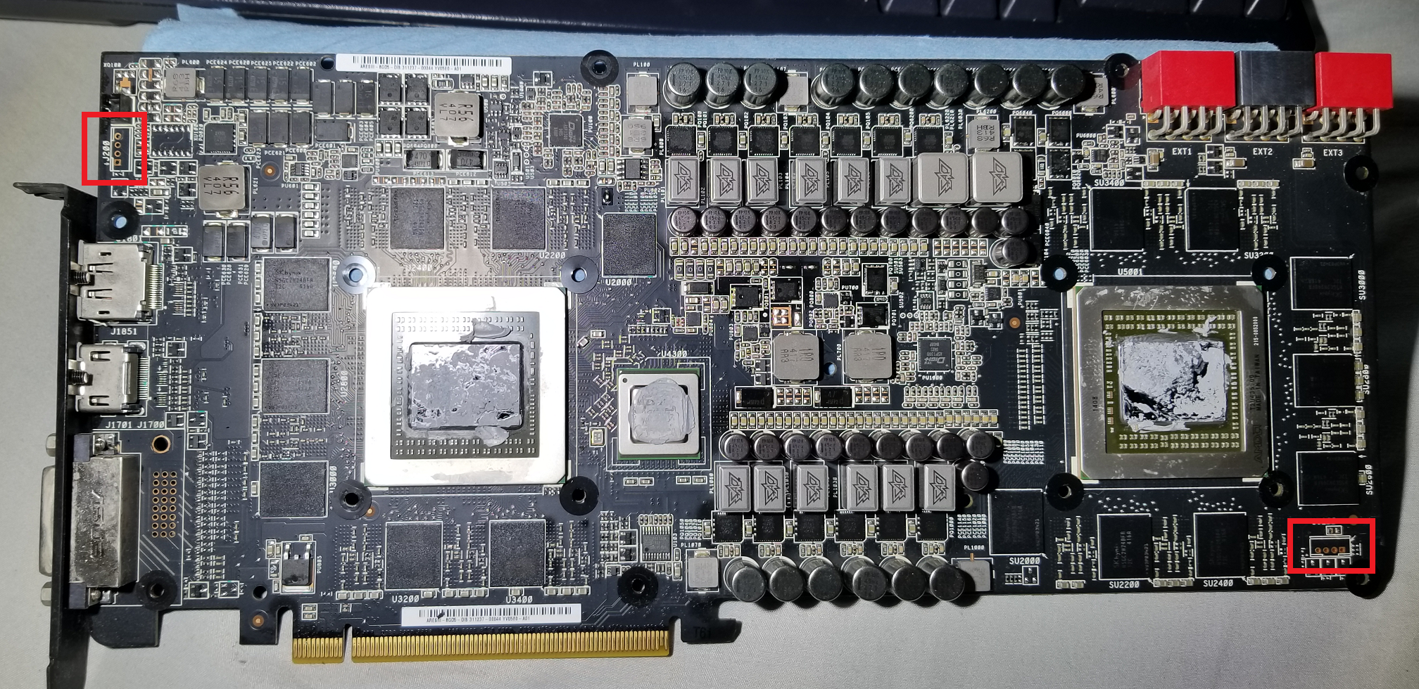

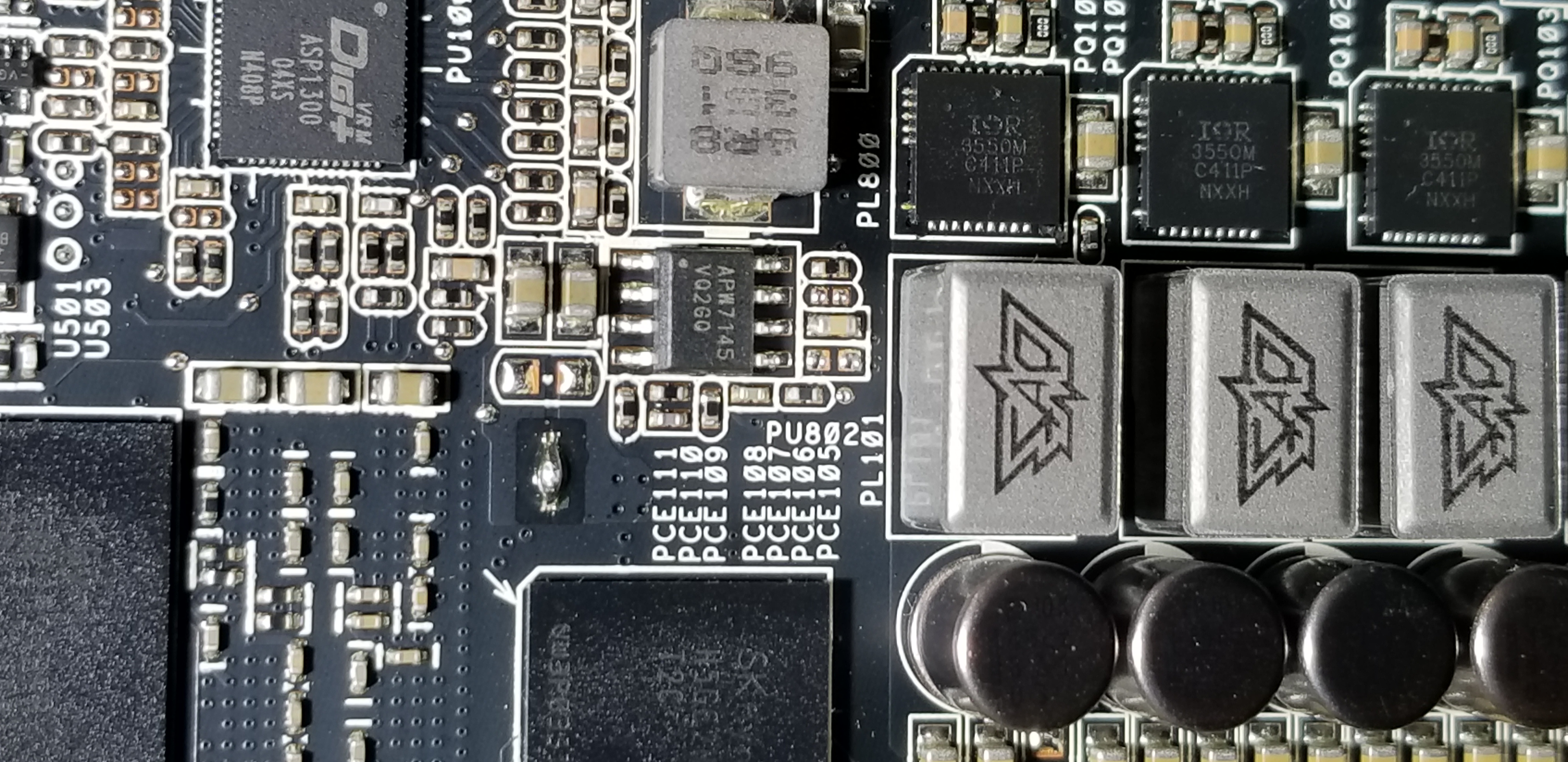

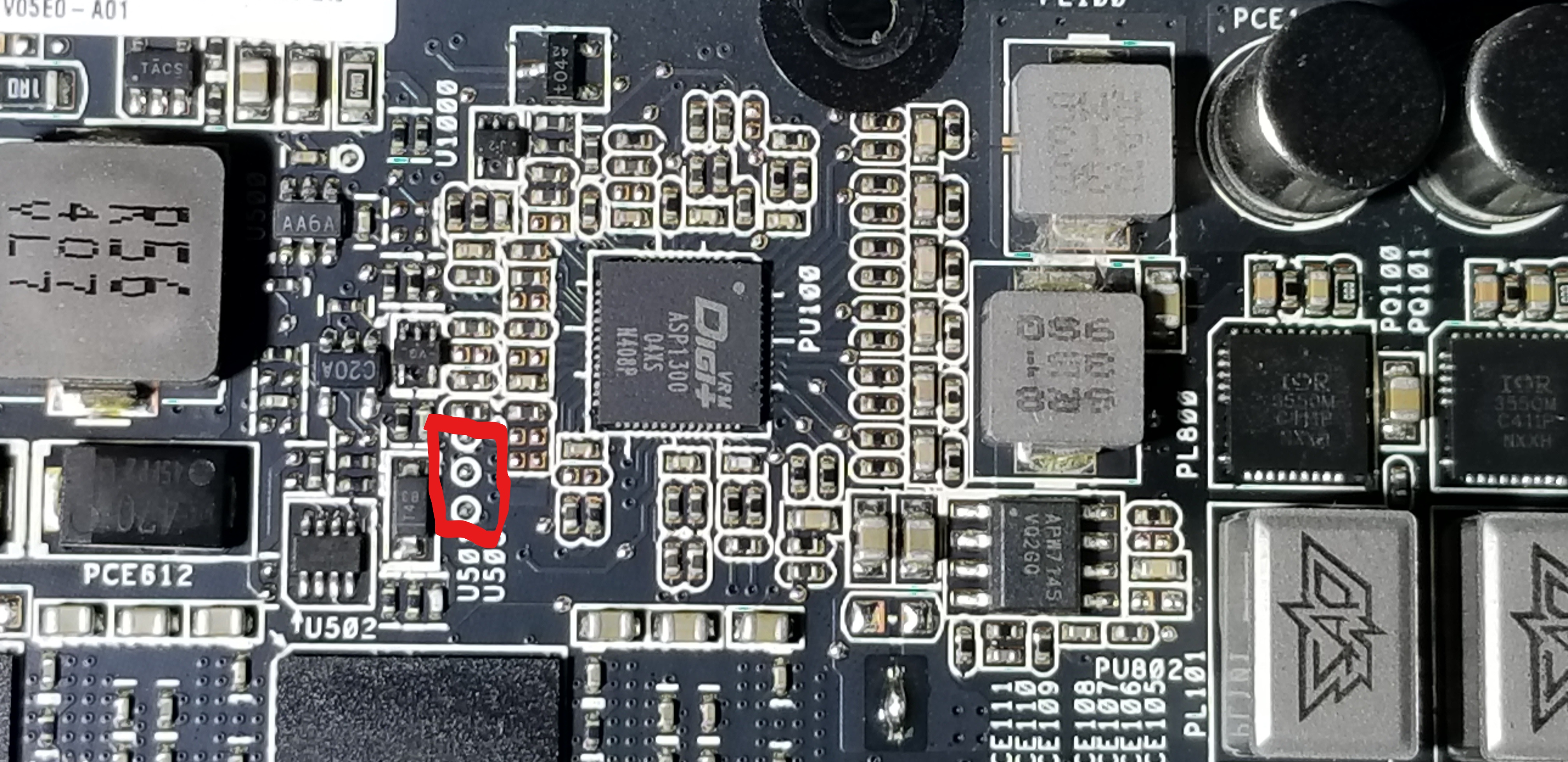

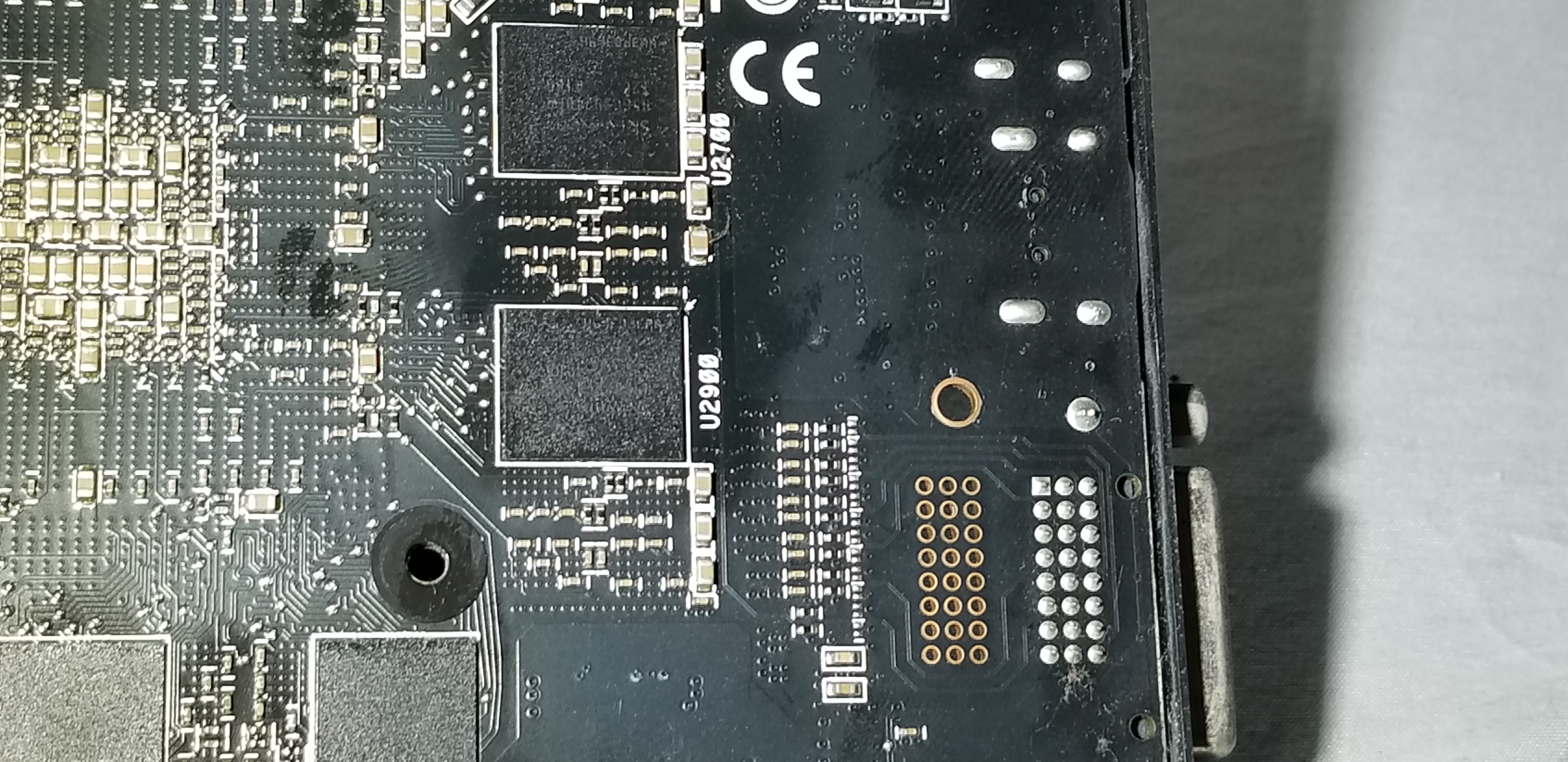

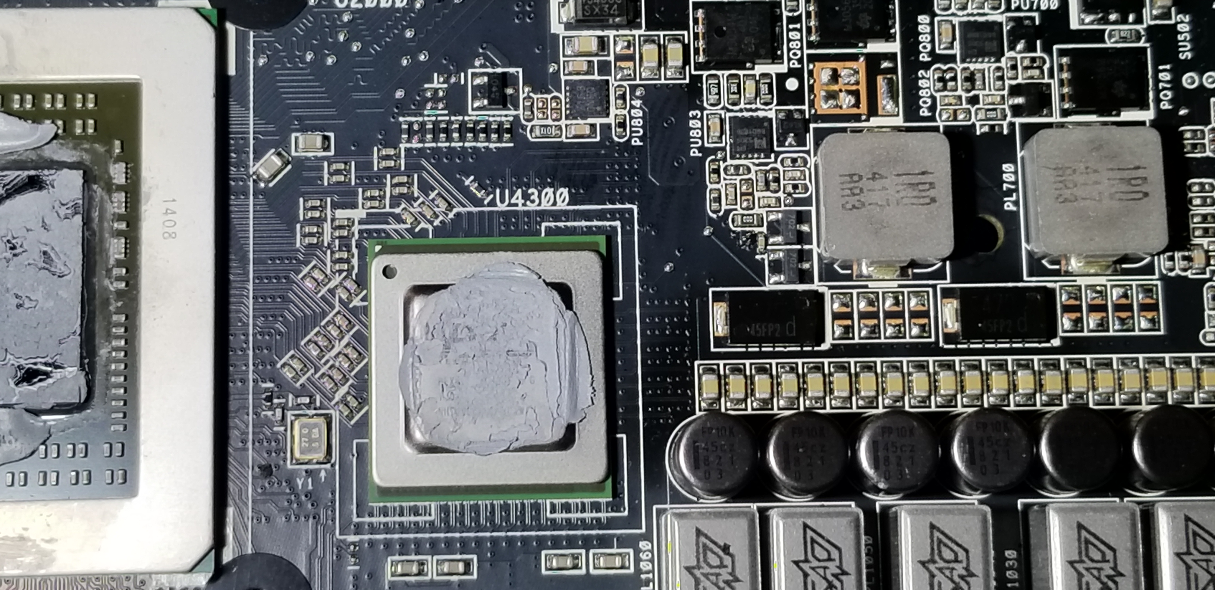

Quote from MsiMax on 2020-08-13, 09:42Looking for the i2c bus on the board which I believe is the 2 pass on the bottom right pins 24 and 25 lead to it

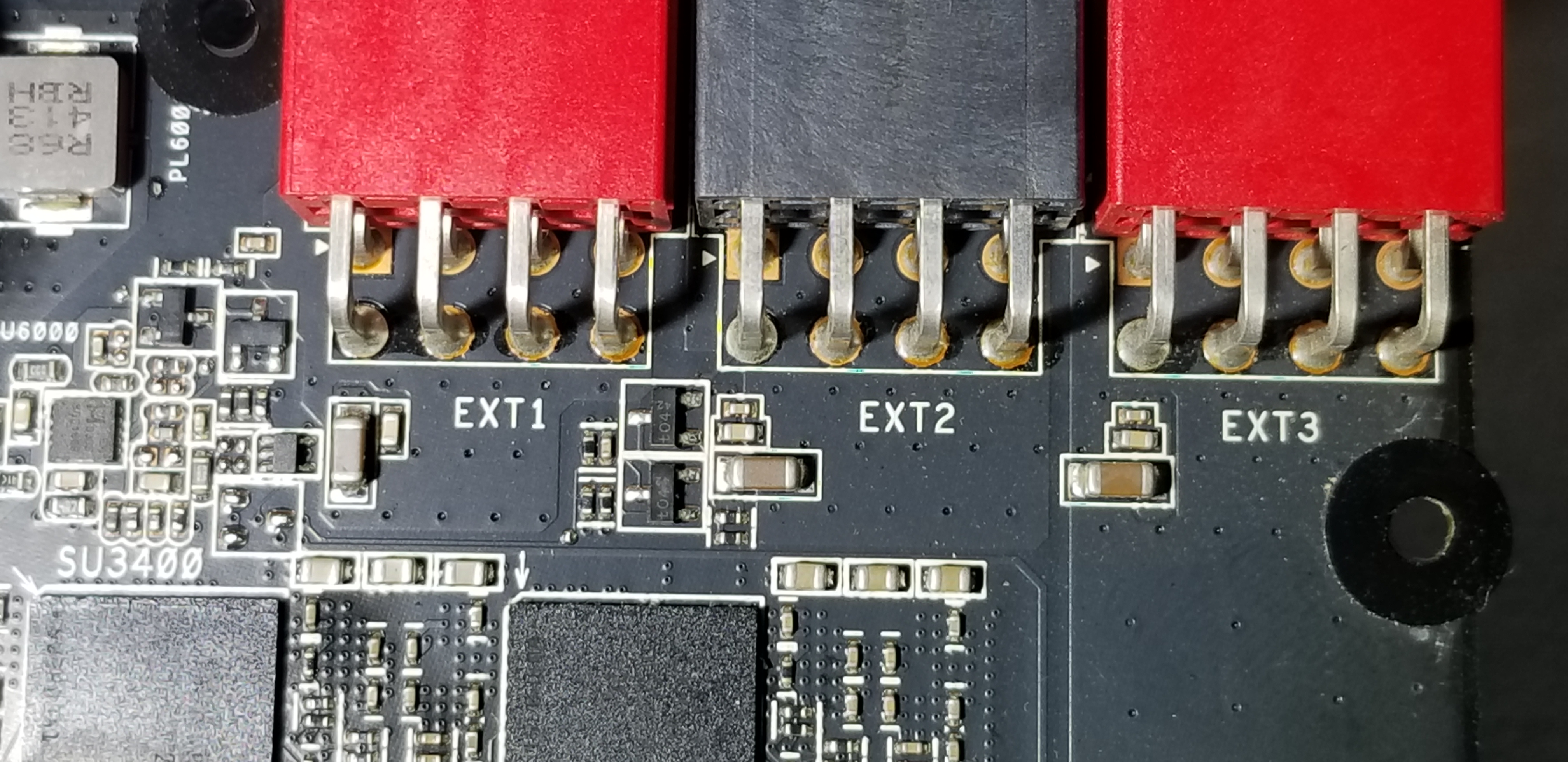

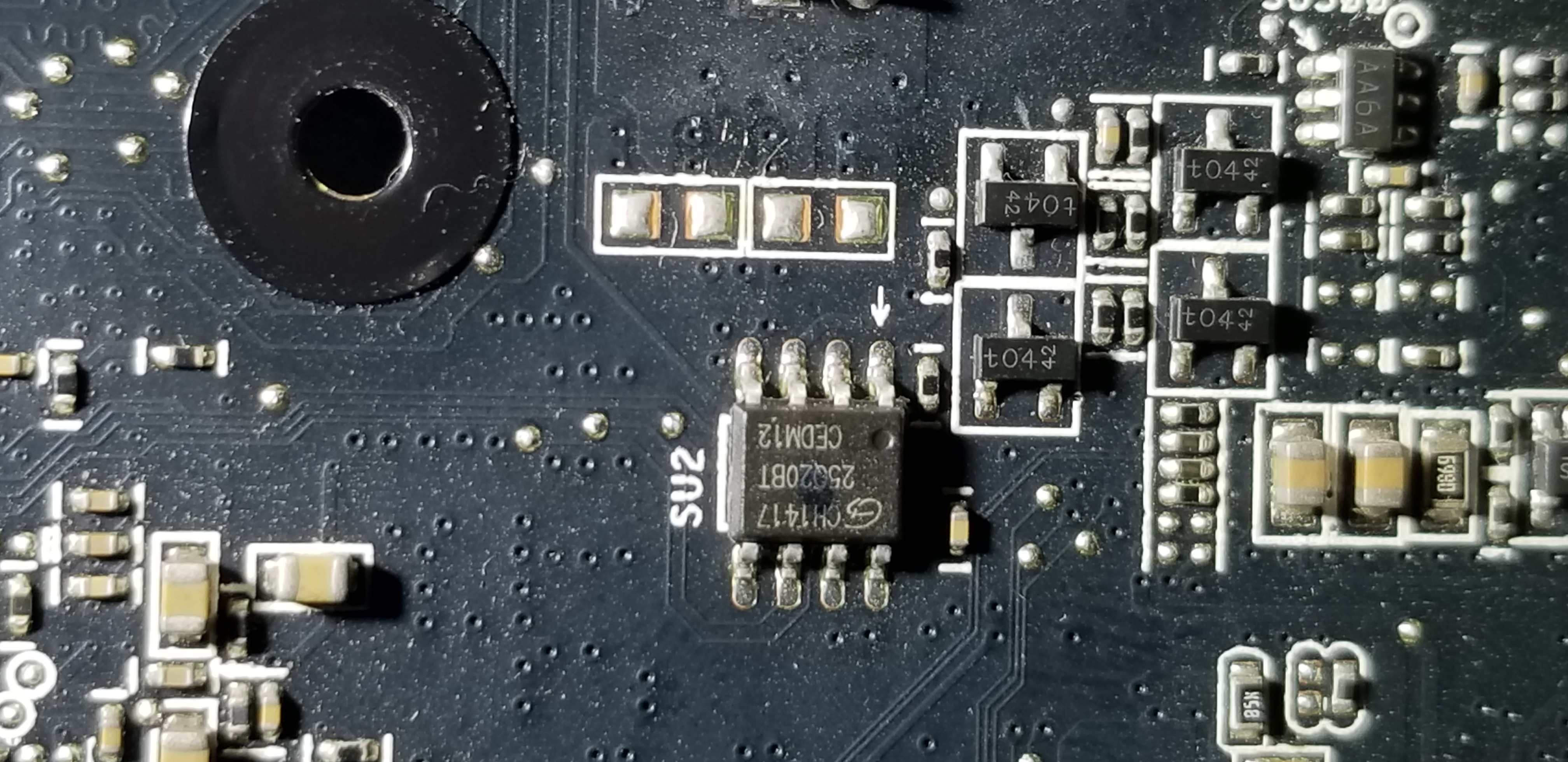

Uploaded files:Quote from elmor on 2020-08-13, 10:51Looks good, I think this should be supported and auto-detect in the software. The pins should be the ones you indicated. You can also check if the headers are connected to SDA/SCL for an easier connection spot.

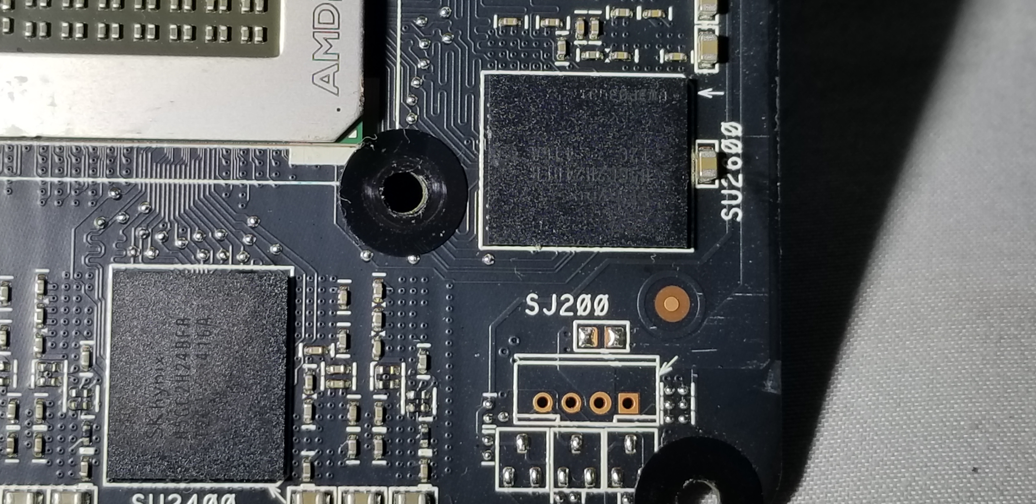

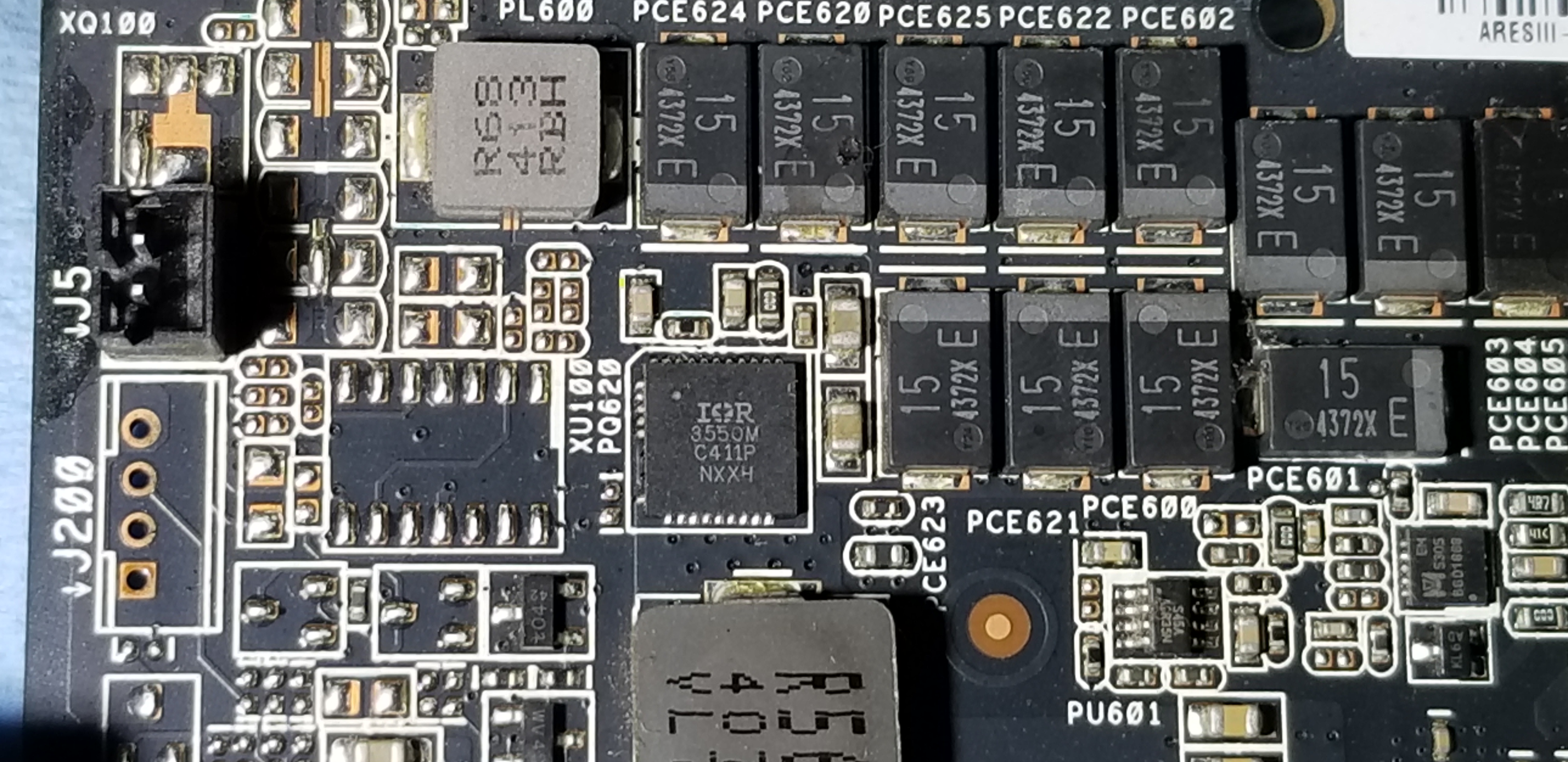

Uploaded files:Quote from MsiMax on 2020-08-13, 12:01theres only continuity across pin 1 on j200 and both solder points on the opposite of what you have highlighted
