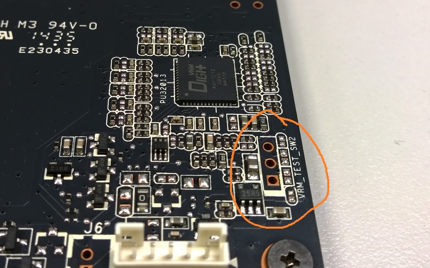

Quote from xinoxide on 2021-02-22, 07:20Does your 980 strix have this port at the end of PCB?
If its any bit different than the norm please post pics. I came here with a 1080ti strix with 2080 ti VC on it.
Uploaded files:Quote from cedricba2003 on 2021-02-23, 04:53Yes, its the same. I assume there no different then the ports I have. One should be SDA, one SDL, and the last one ground. Sorry, but what does VC stand for? I'm not sure.
Quote from xinoxide on 2021-02-23, 22:19Ok. Center pin is always ground on asus nvidia cards. the other 2 you can flip if it doesn't work.
Then depending on which controller you have some settings may differ.

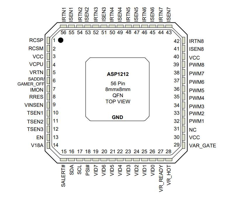

Quote from cedricba2003 on 2021-02-23, 23:57I measured them and hooked the evc2sx up already. But ground is not the middle one, its the one on the right side. Then SCL is in the middle and SDA is on the left if you look at the card rotated to the right.
This is my Voltage controller. Its an ASP1212:
Uploaded files:Quote from xinoxide on 2021-02-24, 00:03Oh good. I'm sorry but I didn't expect you are even this far.
Can you detect and pull the current configuration? Elmor may need it to make a control configuration.
I don't see support for ASP1212 yet.

Quote from elmor on 2021-02-26, 13:58Quote from xinoxide on 2021-02-23, 22:19Ok. Center pin is always ground on asus nvidia cards. the other 2 you can flip if it doesn't work.
Not necessarily, it really depends on the brand of the VRM controller. IR/Infineon should match the EVC2 pinout (GND/SDA/SCL) while other vendors may use a different arrangement.
Quote from xinoxide on 2021-02-26, 22:07I appreciate the heads up. every nvidia card so far has been gnd to center pin so, I have not yet run into something to give me any ideas otherwise.
