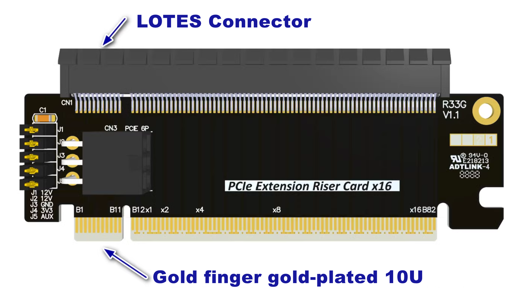

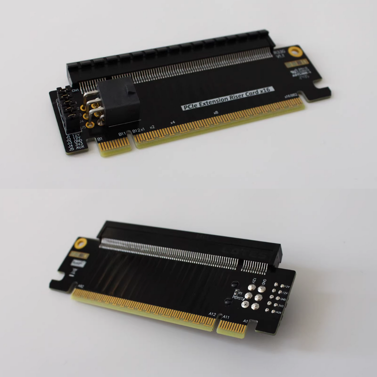

In order for the PMD (Power Measurement Device) to be able to measure the full power consumption of a graphics card it’s also necessary to account for the power provided through the PCIe slot. Therefore we offer this PCIe adapter card that allows you to provide the slot power from an external source through a 6-pin + 2-pin PCIe connector. The adapter is rated for PCIe 5.0 (x16 lanes at Gen 5 speeds). It does not allow for measurement of the 3.3V and 3.3VA rails.
